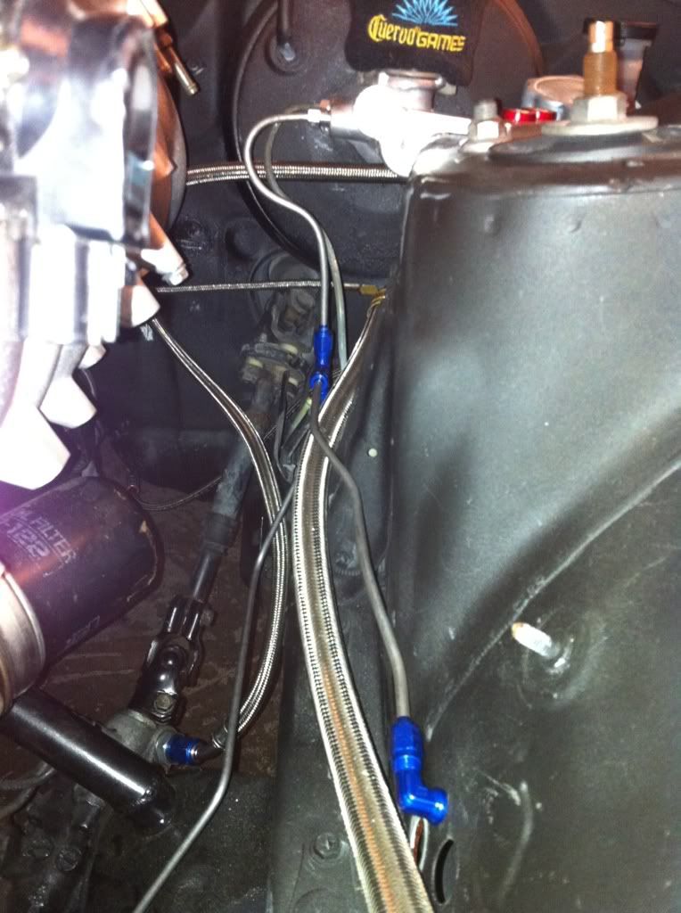

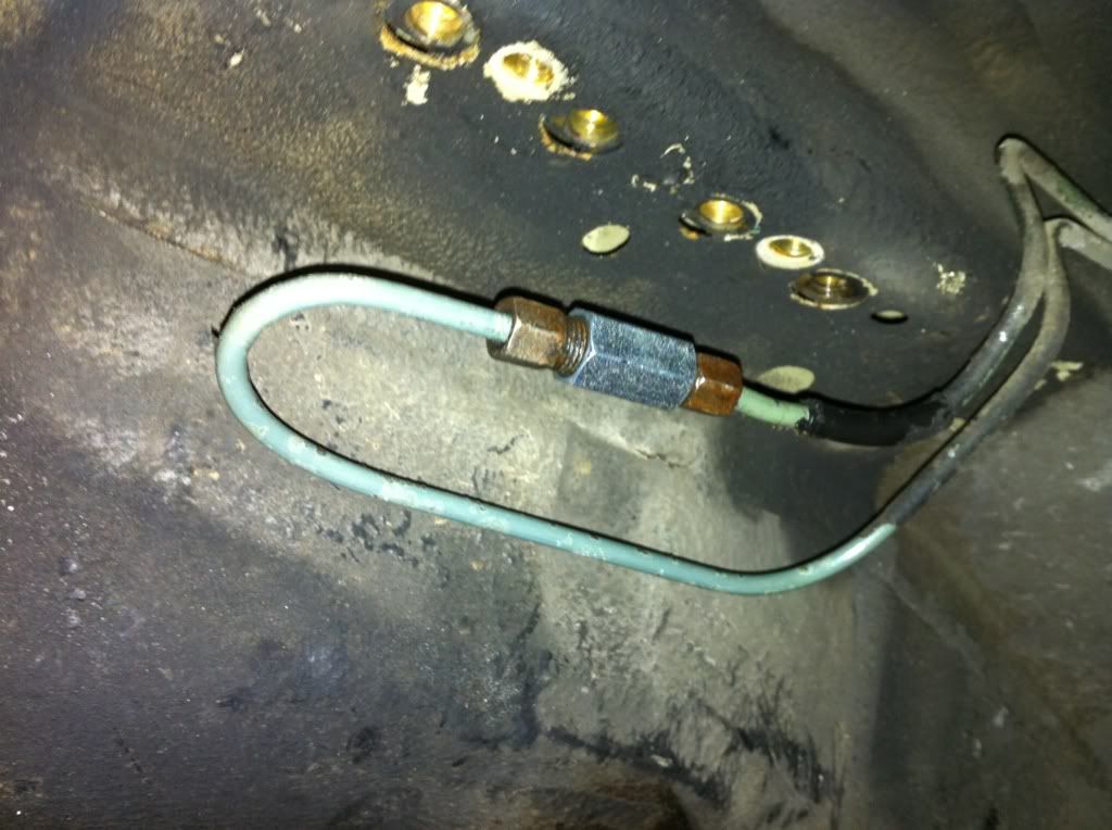

Also, see below for the only pictures of an ABS delete I have ever seen on a Z32
Front Brakes
Rear, bypassing module
